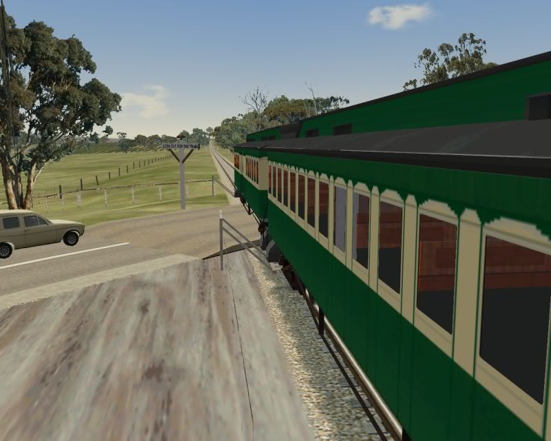

Here's a bland shot with no distant mountains enabled and a foggy horizon. For country so hilly, it is absurd that there is nothing whatsoever in sight more than a kilometre awayIPB Image

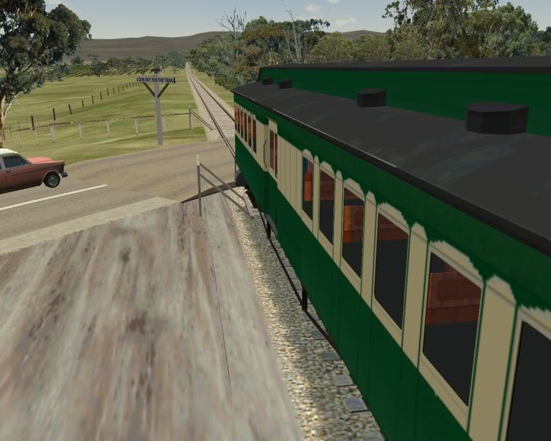

Now here's a shot in the same location with distant mountains enabled, bearing somewhat of a topographical resemblance to the actual locality
