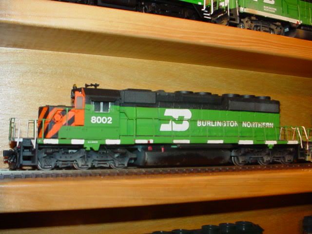

I've been using a Paasche for about four years and I really like it. Simple, reliable, easy to clean and American made too. The only thing about it is that it is a single action brush. I really should have spent a little more on a dual action brush. I've used mine to weather over 300 pieces of rolling stock and completely paint another twenty or so. Personally I am really fond of Floquil paints, but I have managed to get good results with Pollyscale too. With Floquil I usually thin it down to 85% paint-15% thinner instead of the recommended 75-15%, which is too thin for my taste. I have found that fine line tape is a must have for painting diesels. You can get it in most auto parts stores. It is pricey, but it is definitely worth it when your favorite railroad uses lots of stripes.
Sorry about the lousy picture, this look a lot better in real life...
Collin

Posted 11 July 2008 - 03:17 AM
Did you paint that yourself?! And is that a Cannon cab or is it just modified? Looks great! BTW Bradley, are you still having problems?

Yep, that is my paint job. The cab, nose, sub base, fans and intake grills are Cannon. The unit was a snoot nosed CP model that I got on sale. I stripped off the factory paint and applied an off white primer. Then I sprayed it white and masked the appropriate areas as soon as it was dry. Then I sprayed orange followed by green and black. I used microscale decals for the lettering and logos only. The decal set included the tiger stripes but I decided to paint them on instead.
